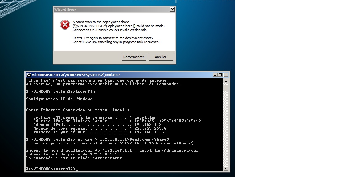

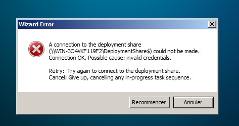

    Hello,
    I want to ask you my problem because i've already search on the web during many hours and i've find nothing.
    With VirtualBox, i've installed 2008 R2 x64 (AD, DNS, WDS, DHCP), MDT 2012 and AIK. I use boot.wim and install.wim from a Windows 7 x86.
    If I put the boot.wim and install.wim in WDS without touch MDT, i can boot on PXE client and the install can be does. But when i put the install.wim on MDT 2012
    and the saving the configuration in order to create a LiteTouchPE_x86.wim and put it on WDS, when i boot with the client, i've this message :

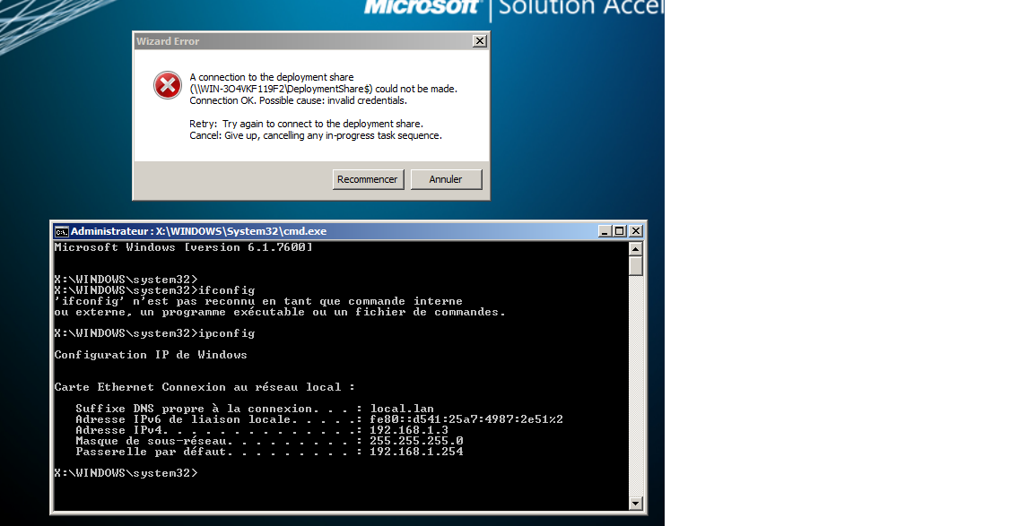

    But i have a valid IP :

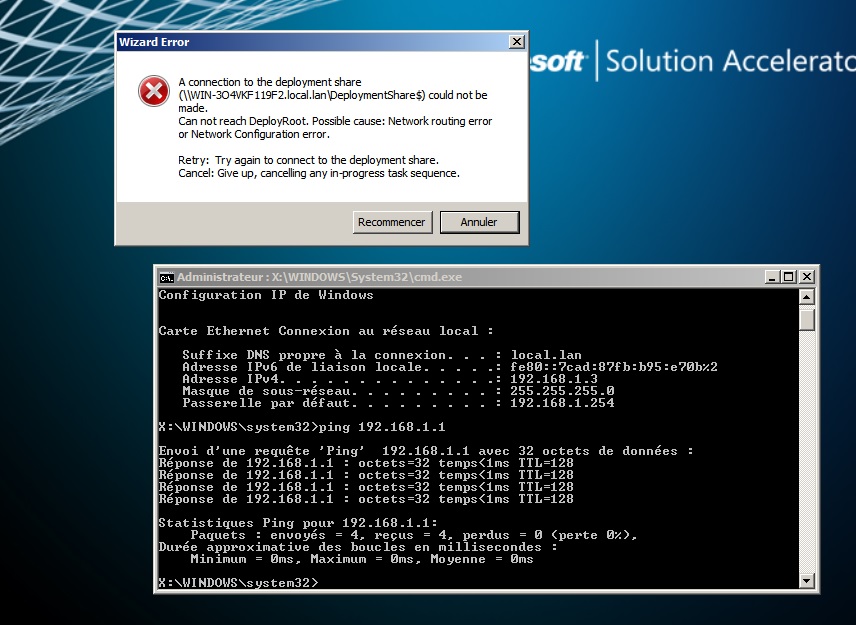

    And i can access to my share :

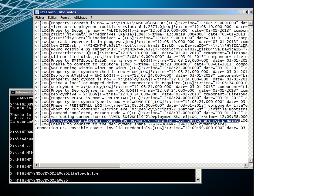

    And the log say me :
    My BOOTSTRAP.INI :

  • Friday, March 01, 2013 11:42 AM
    i know that for vmware i had to add the network drivers from intel or i would get the same problem.
    might be that you need specific drivers for the NIC virtual box is trying to emulate as well.

    Pls try to use ip address instead of computer name in bootstrap.ini, like this DeployRoot=\\Ip\DeploymentShare$
    blacktitann
  • Friday, March 01, 2013 1:50 PM
    Already try...

    And on LiteTouch.log, i can see : no networking adapters found the network drivers for your device are not present
    But it is the first time i've the message on the wizard error on the screenshot
