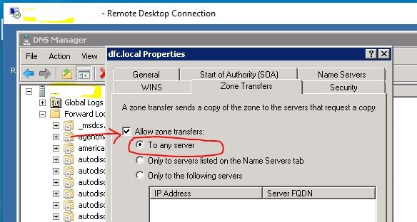

    I have 32 DC servers, we have 3 DCs (Windows 2008 R2 Ent.) that have been identified with the setting :
    Allow zone transfer checked, and also To any server (which is unsecure)

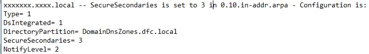

    I have installed RMT  in my workstation to run scripts with PowerShell v5. I am domain admin but My script will always read
    but if I connect directly to the server and verify with DNSMGR and Regedit I get the image above and SecureSecondaries is set to 0
