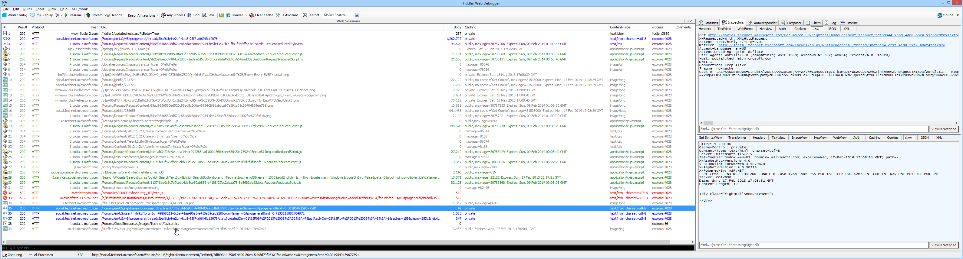

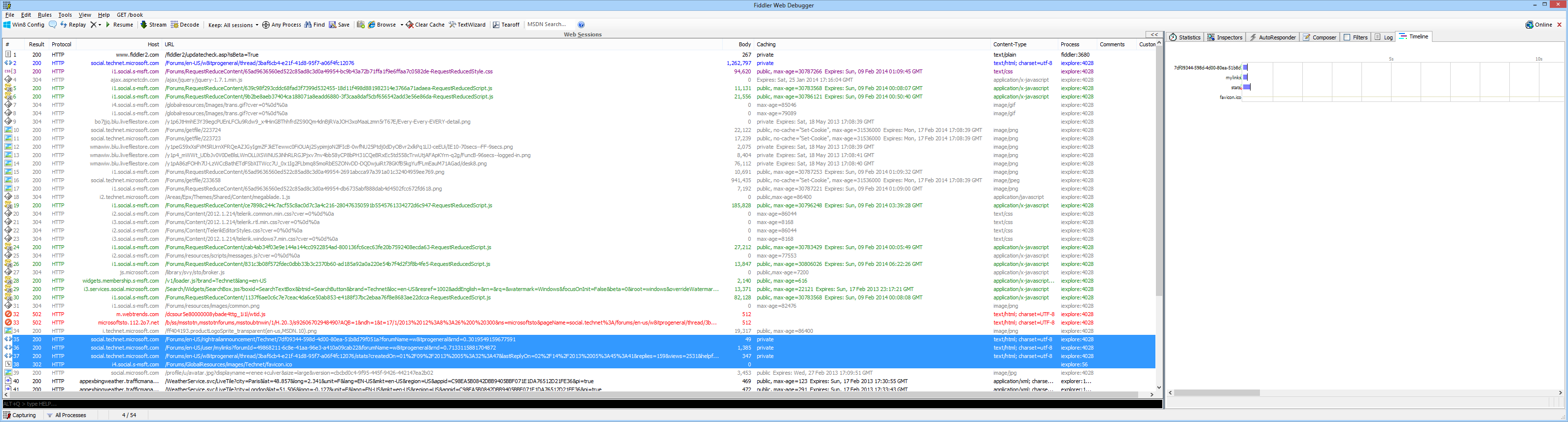

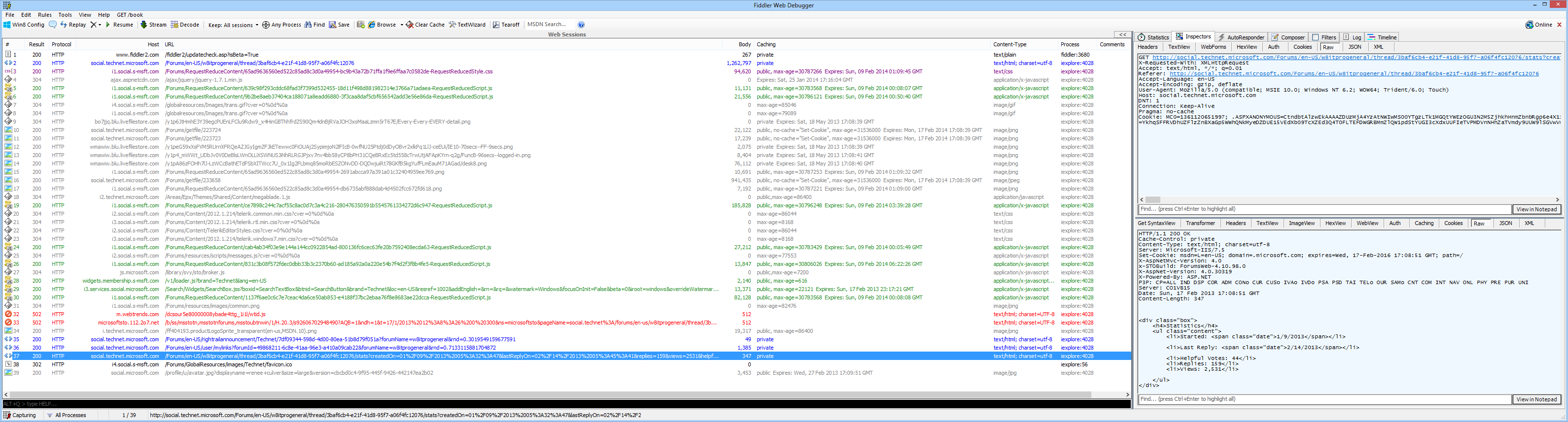

    BTW after the fan got going I decided to start a Network Capture too.  Nothing happened there until the end when this turned up
    URL Method Result Type Received Taken Initiator Wait‎‎ Start‎‎ Request‎‎ Response‎‎ Cache read‎‎ Gap‎‎
    http://widgets.membership.s-msft.com/v1/user/usercard/?id=<REMOVED>&lang=en-US&brand=Technet&callback=jsonp_loadUserData0 GET 200 application/json 82.31 KB 0.78 s <script> 0 63 515 202 0 1125485
    That looks familiar, e.g. see my "before I signed in" result above.

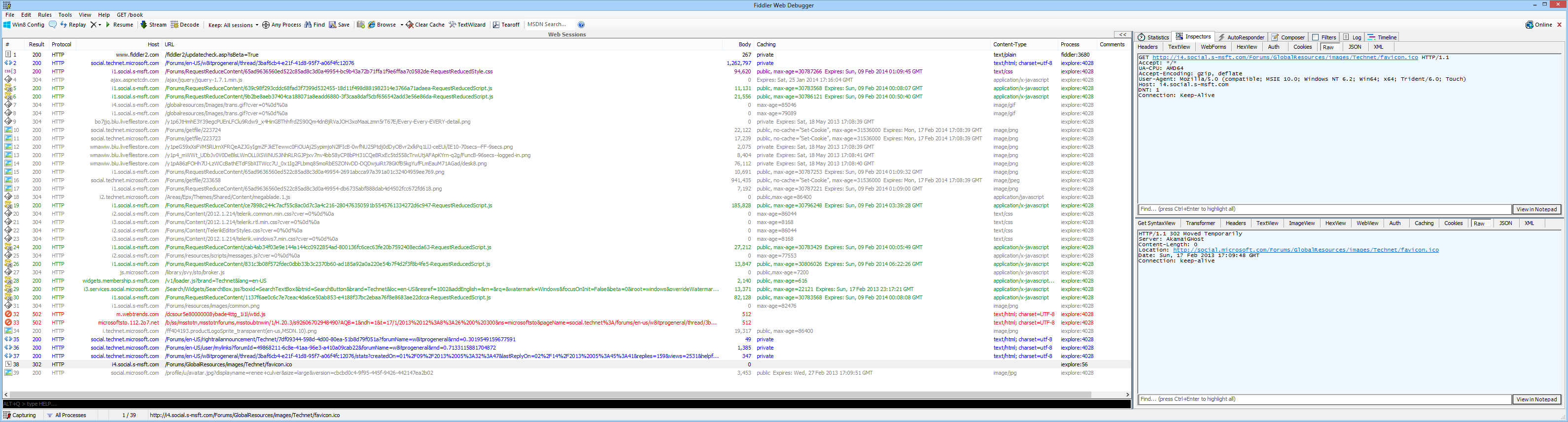

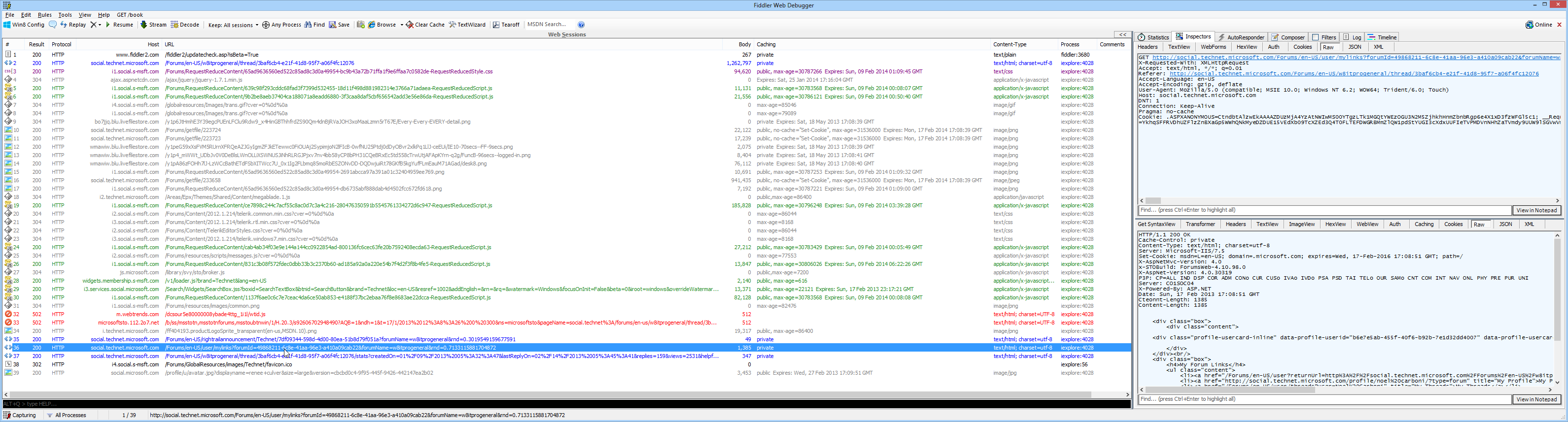

  • Well, in that F12 Dev Tools Network timing chart you're referring to, those four extremely long yellow bars represent Ajax calls. (I looked it up).  They're not the cause of the delay.  They're the effect of it.
    I see only 3 long bars, but to confirm your observation that the long bars are the result of a long running script locally, I fired up Fiddler (a web request tracing tool found at http://www.fiddler2.com/fiddler2/).  Sure enough, there were three requests just prior to the long delay, BUT the responses were received immediately, the server did not delay.  Somewhere likely in the processing of those three responses (or possibly just coincidentally) a script delayed IE from doing anything else.
    Here are some wide screen grabs showing those three requests and a summary that shows the timing.
    IE10 F12 Network Trace Showing 3 Requests with Very Long Delays
    Fiddler Capture of First Long Request
    Fiddler Capture of Second Long Request
    Fiddler Capture of Third Long Request
    Fiddler Capture of Next Request Immediately Following the Almost 1 Mnute Delay
    Fiddler Relative Timing Showing the First Three Requests Completing in a Small Fraction of a Second
    -Noel
